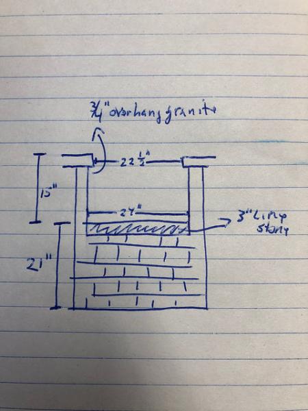

I am getting a green egg. it is going to be sitting on a piece of 3 inch limestone. here is my question and I was running this by Cliff before.
If I use the nest it will make my grate height 42 inches off the ground due to the finished height of my limestone being 21 inches. If I don't use the nest I will be sitting at 39 inches.
1. do you all think 42 inches is too high vs 39 inches?
2. Since I'm sitting on solid limestone do i even need the nest? there is no airflow under the egg so i figured i could skip the nest and sit right on my stone.
opinions. . .
i'm also not set on the green egg yet. i just hovered to it cause it's the one i see the most in my area. . .

My Egg is built into my BBQ deck. You done need the nest BUT the air inlet door is on the bottom of the Egg so access to that door with a good amount of room around it is essential.
Can you post a picture of your layout?
And you ABSOLUTELY NEED the ceramic plate-setter for indirect smoking ...

hey mat these r 2 unfinished pics. u can see i have all brick around. there is a hood over the area too. picture a 3 inch thick piece of limestone in that opening and pavers on the floor. so the egg will be 42 inches off the pavers. with no metal nest under the egg i will be at 39.5 inches.
i have seen pics on the net without anything under them. i figure i would be good cause it's all fireproof surfaces. the vent will have breathign room cause it's totally open to the air.
what do you think?

You need it to act as a fire wall between the hot coals and the grate. It forces all the hot air and smoke to convect around the food. It’s an absolute must-have for smoking at low temp.
Your setup is AWESOME (love the overhead vent...super smart way to go!). You do not need the nest. The EGG weighs a TON and when you set it into place it will not move. I’ve seen setups where people suspend them in the cutout but that’s just a waste in my opinion. Honestly I wish my setup were more like yours as mine is built into the counter too and so I have to contort myself a bit to get to the lower air vent. Your setup is perfect.

It is suggested you have an air gap below the Egg to help keep isolate it, otherwise your stone base would act as a heat sink.
Mine actually sits on a concrete base inside the BBQ deck. It’s direct contact and I still can get my Egg to go anywhere from 200F on the low end to +750F on the high end. So I’m not sure that the bottom contact matters all that much. One could put some fire brick or glass fiber insulation under it but I don’t think it really matters that much. That’s been my experience with it.
From the manufacturer website : "THE EGG IS DESIGNED TO BE USED IN A METAL NEST OR WITH A METAL TABLE NEST, PROVIDING AN AIR GAP BELOW THE EGG –"
I understand that. But I think the purpose of the admonition is to avoid burns, not loss of heat. The ceramic gets hot, there’s no doubt about that. The nest would create an air break which would keep the smoker from transferring heat to another structure which can cause burns. However, Jim’s design is brick with a slab of limestone underneath it. There will be some heat transfer but nothing worse than what one finds in a brick fireplace. So, in my opinion and with 5 seasons worth of experience running my Egg, I can say that not having the nest has not caused me any negative consequences.
Take it for what it’s worth....
