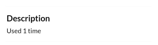

^^^^^ there are always a bunch for sale on my Offerup app. I always chuckle that the person won't need to caulk 500ft again anytime soon and would buy one used from a fellow homeowner knowing it was most likely used once.

*the fancy ones are going for $120 to $175 but still a savings.
