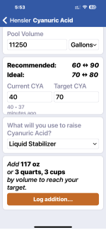

Pool Math is telling me to add 117 ounces to get to 70 should do that in 2 doses or more?
Something is wrong with your calculation. I'm getting 50 oz to increase by 30 ppm.

I am just going off pool math with my current CYA of 40 and using liquid conditioner show 117 ounces. What am I doing wrong?

I got it. I calculated using granular stabilizer. For liquid that looks correct.
