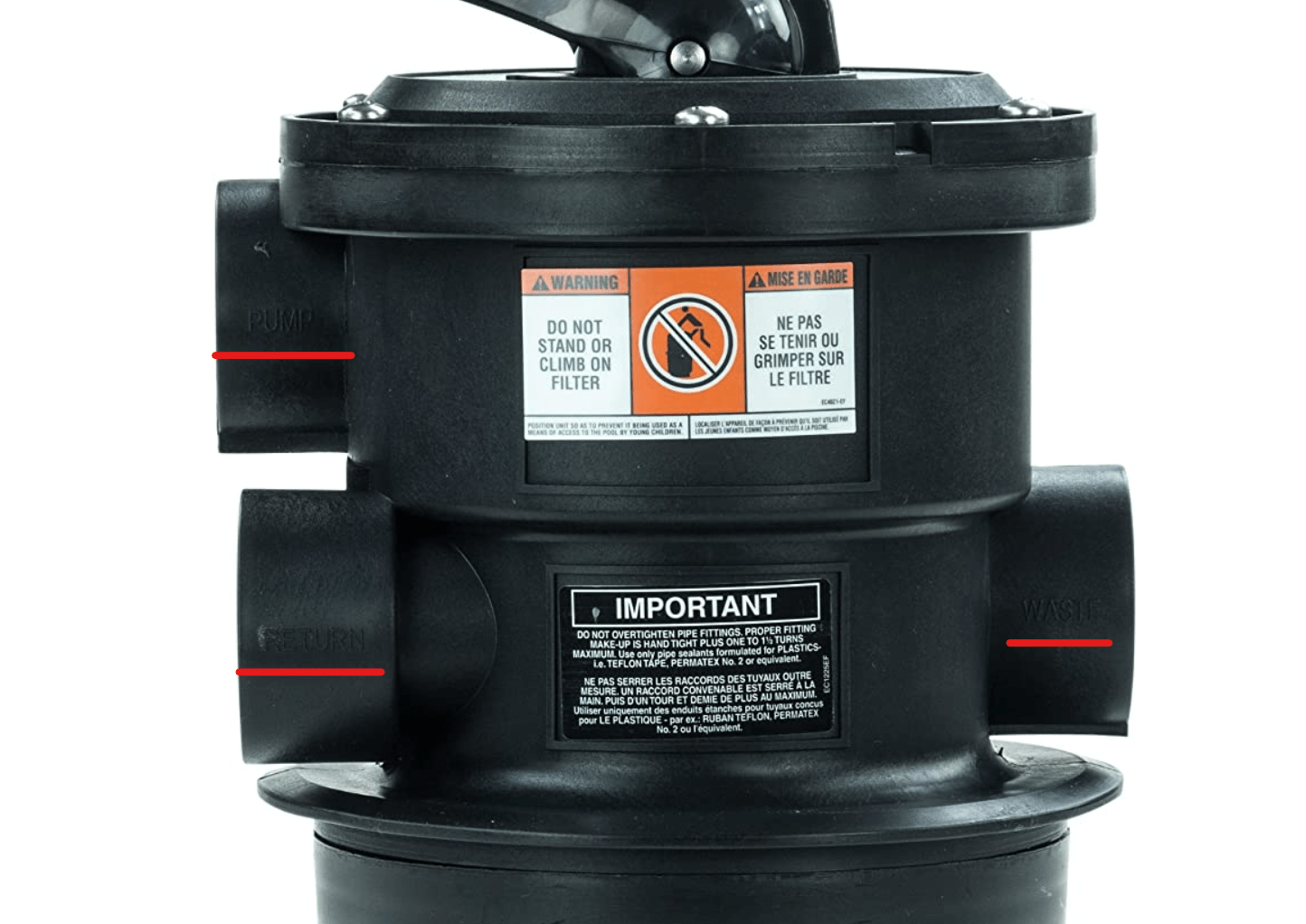

Hello! My pool has been cloudy since I’ve opened it done everything including just replace the head on my Hayward filter in. Now it will not backwash? Help please
As soon I as I get back to the house I will!
Can you show the whole thing in a single picture?
Omg i’m so embarrassed LOL. Thank you so much I will turn those around and hopefully everything works out I appreciate your help!!!!The line from the pump goes to the top port.
You have the pump and return lines reversed.
