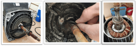

Good news, I temporarily repaired my PB4SQ booster pump allowing me time to find a suitable replacement.
For reference, the local pool builder wanted $1,100 to install a new pump.
I bought this kit from Amazon (don't, it's missing two important seals) Amazon Link and pulled the motor apart. I was shocked how much corrosion was stuck to the metal causing the black paint to bubble/peel away. It looks like water reached the main motor bearing.
I used a wire brush to scrape the corrosion, removed rust from bolts and swapped seals. I didn't paint the inside of the metal housing, something I'll probably regret. The pump has been reinstalled and is working/not leaking. I don't trust my work so I'll still buy a backup as referenced earlier in this thread.
