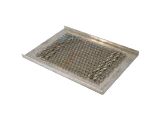

Looks like Coverstar calls them "walk on lids" :)
This is just one of the trays..
And 1 bracket..
And here is one being installed :)
