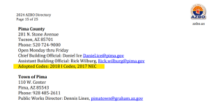

Adopted Codes: 2018 I Codes, 2017 NEC

It says that they have adopted the 2018 I Codes and the 2017 NEC, so that makes it applicable building code.
The 2018 International Swimming Pool and Spa Code (ISPSC) is adopted, so that applies.
The 2018 International Swimming Pool and Spa Code (ISPSC) specifies the requirements for Hand Holds.
So, it seems clear that the AHJ has indicated that handholds are required as specified in the code.
You can ask the Inspector if you want because they have the final say on what passes and what does not pass.
  • 2024_AZBO_Directory_.pdf
