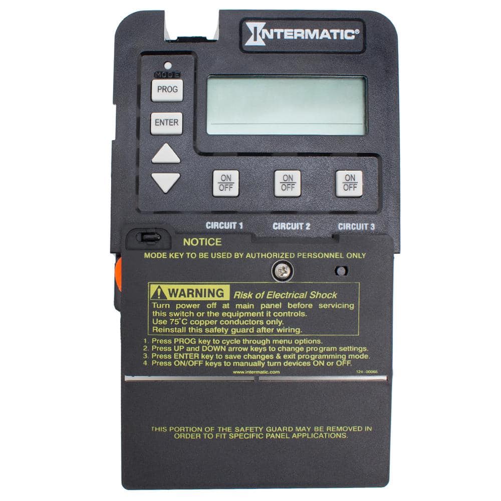

I'm trying to find a timer for my pump. I have a 2hp 110v 2 speed cartridge system by Aquapro. I know I won't be able to control speed with the pump and that's fine. I'm looking for a timer that is digital preferably and has multiple on/off cycles per day.
Look at…
Thank you for that. I guess I also should've mentioned my pump plugs in. Not sure if you can take the plug off and hardwire it. I would imagine you can, but I'd love to find a plug and play timer. I'm fine with it only controlling it on low speed. I only use high to distribute chemicals or when I want to move water quickly.
You can wire an outlet to the timer the pump would plug into.
I think you are making this more complicated then necessary.
Look at the maximum amp draw on the label of your motor. If it is 15 or less, the Intermatic P1121 will work for you. Digital, no. Multiple on/off settings, yes. Plugs in.
