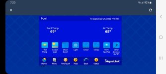

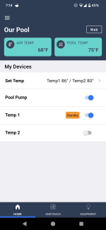

Change heater back to temp1. You should have these in your home page of aqualink. Post a pic.
Changed the speed label back to "Temp 1". And turned off my special OneTouch macro. The pump speed went down to 1750 (my scheduled speed) and heater went into standby even though the temp is well below my maintain temp.Screenshot_20230929-191446.pngScreenshot_20230929-191431.png

Is your heater set to remote mode?
Post a print screen of the main aqualink page.
It might be on cool down mode from running. Give it 10 minutes.
Yes. It's set to remote mode. It controls the heater just fine. Just trying to figure out why it's not automatically increasing speed.
Also I think your speeds are too low for the heater. Mine is set to 3000.
Could be. I'll leave it alone for a bit and see what it does.
2450 seemed to make it kick on, but I'll try higher.

Change both temp1 and 2 to the same speed. I use temp2 for the lowest I want the pool like during the week and then temp1 for when we swim at a higher temp.
Got it. It was just me being impatient. Once I switched the label to Temp 1 and let it do it's thing. It ramped up to 3000rpm and started heating.
