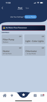

I have tried all speeds :/ the pool start up guy said he will come tomorrow. I got the actuators in the right place
When it’s off so at least the spa isn’t draining. Just no pump until he comes. Thanks again for everyone’s help!
