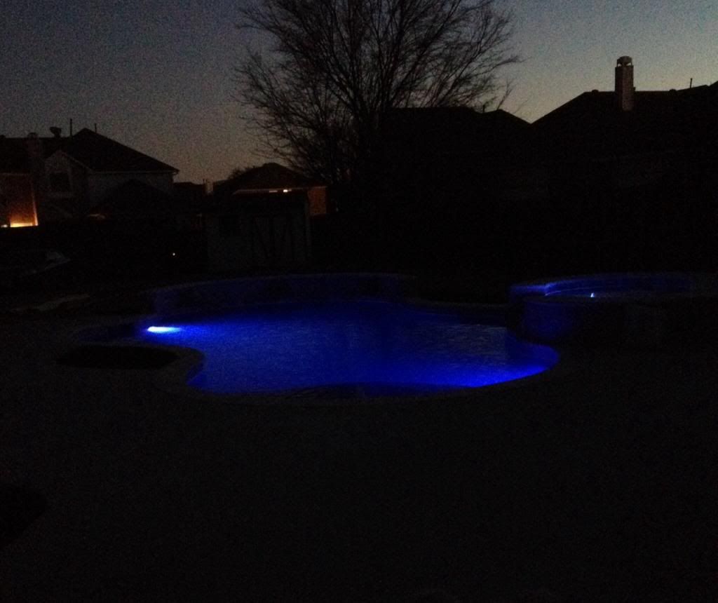

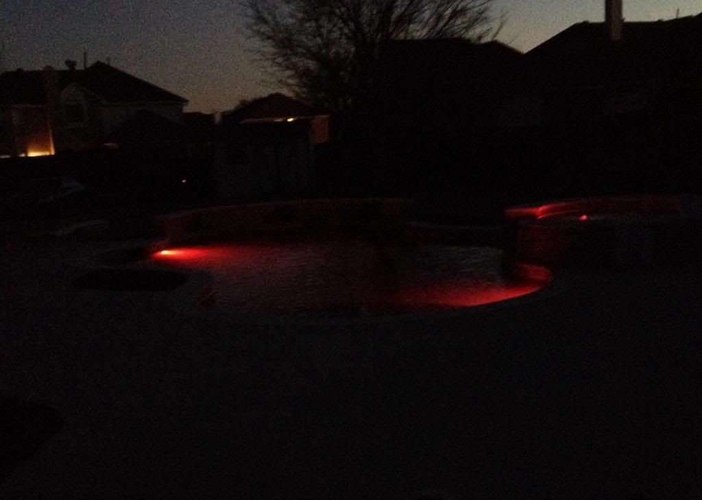

I hope you love it as much as we do! Everyone that's seen it has loved the color! Mr. PB turned things on to clear up more of the plaster dust and said he would program the thing I know everyone wants most - the lights! The water is still a little cloudy but here they are:

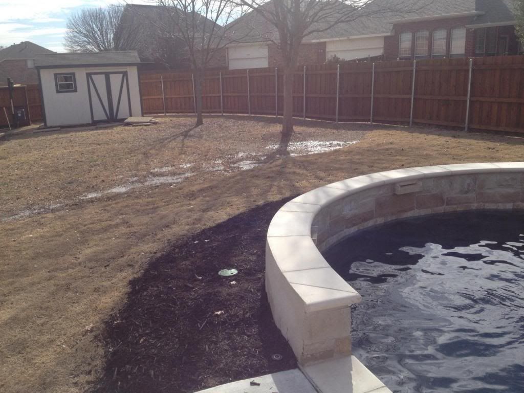

Houston - I think we have a problem! Equipment was turned on yesterday and everything ran all night including the scuppers, went out this morning and noticed this, looks like we have water leeching through the stone wall or a leak of some sort. Sent it to Mr. PB, waiting on his response. What do you think?
Mr. PB was just here - there's a leak, they are going to have to pull the coping off the back wall to see if they can find the problem. If not they will have to start taking the wall apart. Also, noticed the water level in the spa had dropped below the tile line, so I stuck the hose in and filled it, he said they would check into that too. ARGH!!!!!

So more strange issues - still no resolution on the leak on the back of the wall, Mr. PB had me turn off the scuppers on Friday and I also added about an inch of water to the pool. On Sunday, I had to add another inch to get the water level even to the bottom of the skimmers. Went out a few hours later to see a small pond forming behind the pool.
Sent a text to Mr. PB and to the owner as well. Plumbers were out this morning saying it was the auto fill but Mr. PB says that pipe was dry and downhill from where the water is, so they were wrong and should be back out tomorrow. The back of the wall is still wet and it's now been three days since the scuppers have run. Sprinklers have not run since last Thursday and no sign of this at that time. Any thoughts?
Mr. PB has been out a couple of days this week checking the water level - still no work done to identify where the leak problem is and on top of that, I noticed this afternoon that there are what appears to be pretty massive calcium deposits now forming on the stone near where the scuppers are located. Scuppers have not run for a week, the back of the wall is still wet. This has got my stomach in knots and regretting this whole project. Short of ripping out the entire wall, I don't know how they will fix it.
