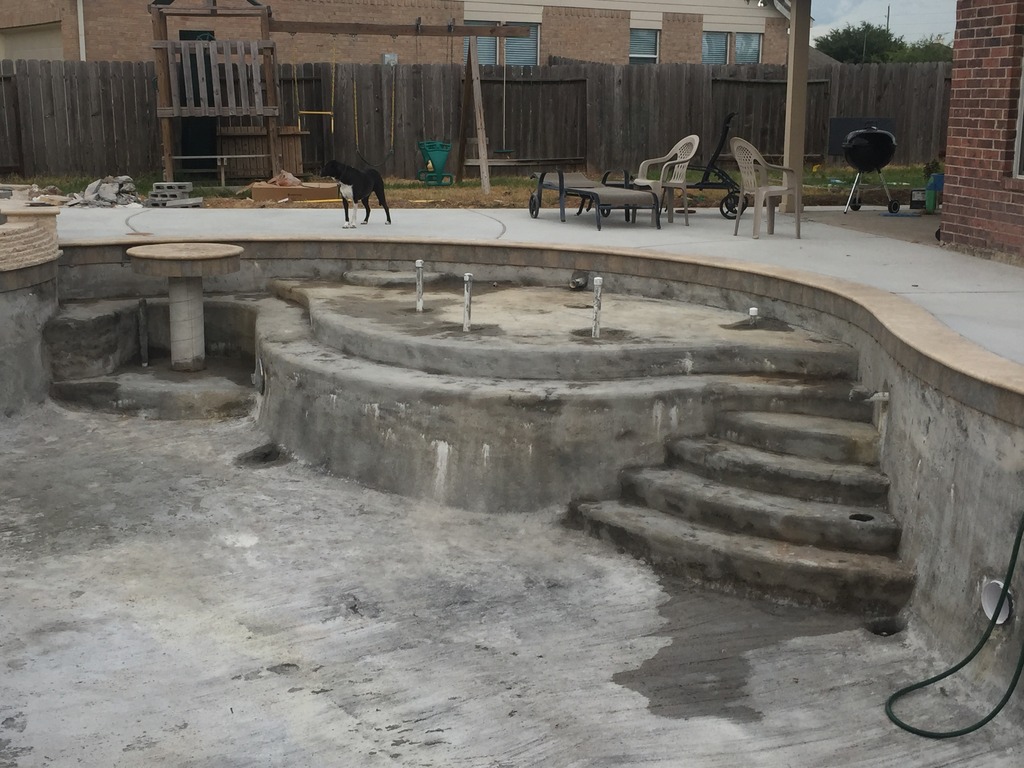

My PB came out this morning to see the tile and also to measure the table benches. We talked and he said he can raise it. It's going to cost me because he said he can't do it for free but it will be $100's and not $1,000's so that is good news. They'll raise it 3 inches as it needs rebar for the cold joint and with 2" he was afraid of cracking, and 4" we'd lose too much leg room. He's trying to figure out how he can get it done before we're supposed to be plastered later this week. I was encouraged by the conversation though he confirmed this was a short person problem as my benches are right on for standard height. He did take some ownership in the problem though in that maybe they should have considered our heights and spoken to us about it without any suggestion from me so that was nice.

We were finally able to take some measurements in the deep end and spa. It rained right after gunite and then the pool didn't ever *not* have water so we weren't able to check those. Looks like we'll be about an inch short in the deep end and 1.5" short in the spa.
Nothing they can do about it now so I haven't said anything. Do you think it's off enough to try and ask them to cover all of raising my table bench?

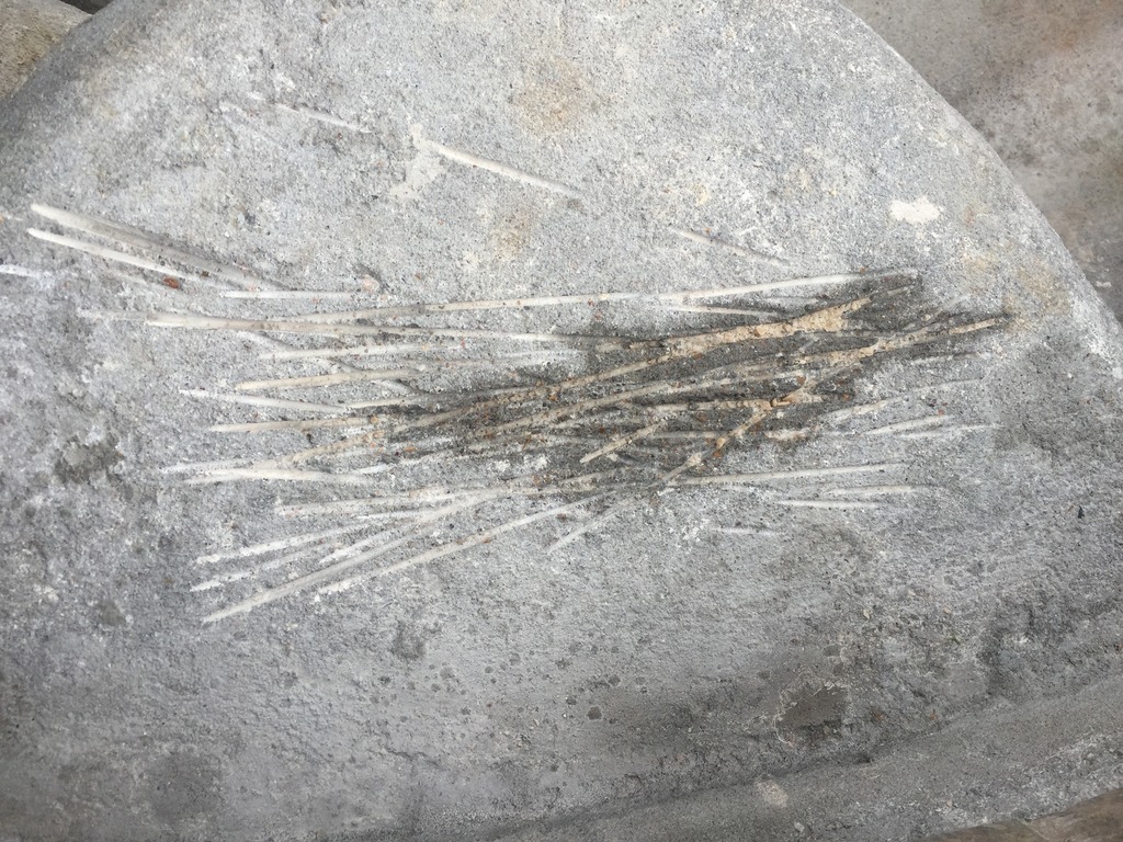

After everything was cleaned up there were a few other things. Is it normal for tile crews to use the gunite as a cutting board for their saws? This is in several spots all over my pool and spa. My PB said it was typical and would get filled in with plaster.
Some of those look an inch deep.
