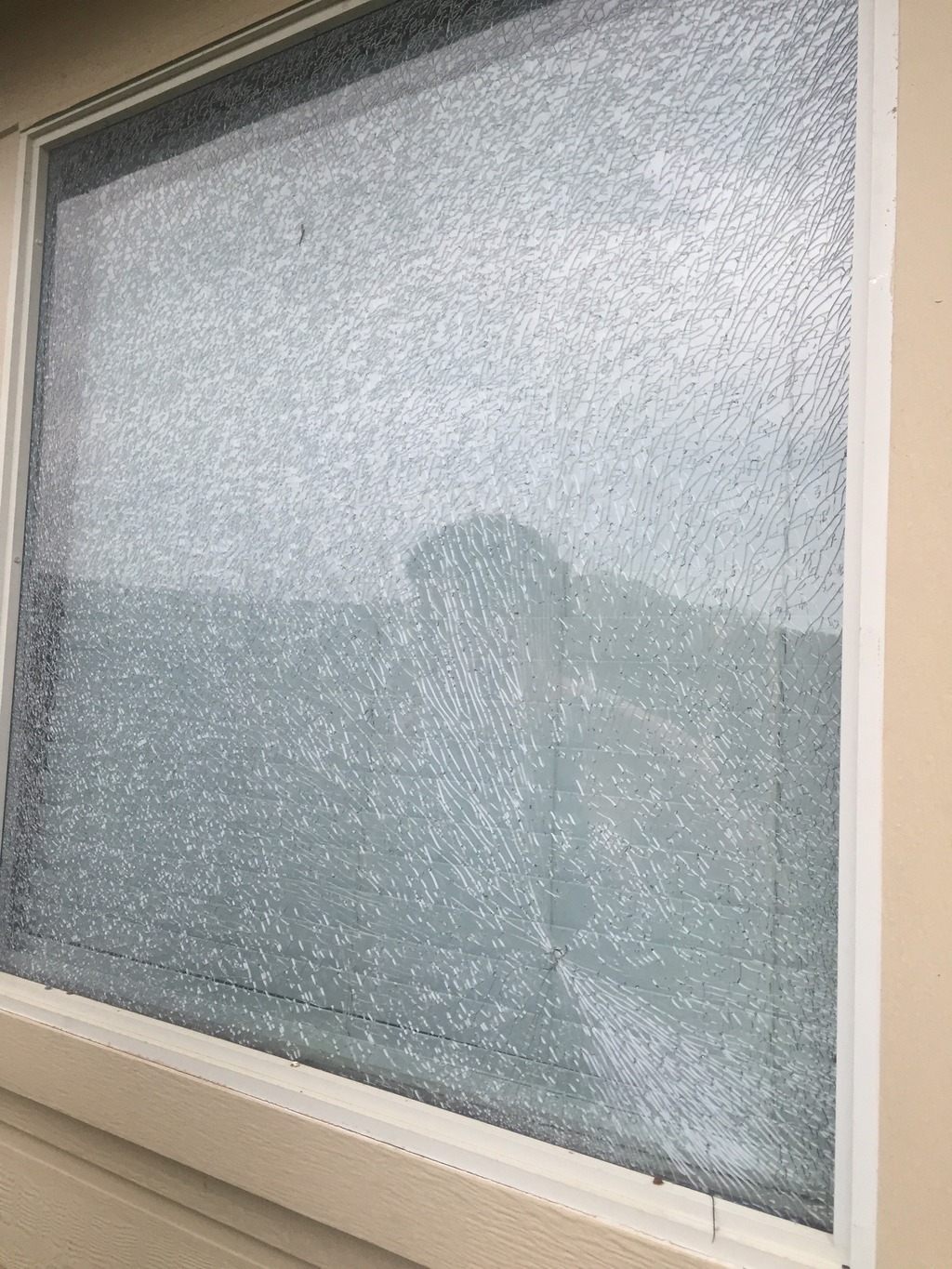

This also happened. We think it was while DH was either mowing or weed eating so that stinks and quotes have ranged from $150-$425 to fix it and they can't get out here until Monday.
Really cool upon closer look though.
Going to put clear contact paper over it and try to save it. What do YOU see!!
