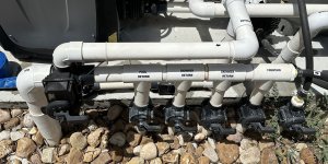

Other question is how do I setup the electric valves for when in spa mode vs regular pool mode via my aqua link app and adjusting the valves? Spa mode seems obvious that I should have pool suction and pool return towards off. But in pool mode, should the spa suction be completely off? What about spa return? See pics below as this is current pool mode via aqua link app, first pic is suction side. It’s always been strange to me because the valves look like spa return is turned off but that can’t be the case because it spills into pool at high speed.

Tell us a little more about the pool and spa. Maybe show a picture of the whole pool/spa and another couple of photos of the equipment pad from different angles. the return shows the spa return is OFF but you have flow to pool return, 2 skimmer returns (do you have 2 skimmers in the pool that are venturi type?) and a fountain. Where is the fountain?
Also there is a black hose at the very end - where is that leading to?
On the suction side, the spa main drain is OFF and the 2 skimmers and pool main drain are full open.

Do you have a dedicated return to the spa that is coming off of your pool returns? It may be underground but you should be able to count how many returns you have in the spa. Does one have flow when in pool mode and others do not? Or if in Spa mode, does one of the returns to the spa not have flow?

This is correct. The Aqualink automation is set up to go rotate the valves between Pool and Spa mode as you indicated.
However if you are having flow into the spa when in Pool Mode and the valves are completely closed to spa jets then there may be another return jet you are not seeing.

Maybe I can take more pics tomorrow but here is some additional information. 2 Venturi skimmers which is the skimmer return lines, the fountain is just a pool jet shooting vertical on the tanning ledge of the pool and black hose goes to the additional pump which runs the cleaner/robot. You’ve confirmed my suspicions by current valve locations but I have no idea how the spa spills over into the pool in that position. Maybe it’s like you said, they connect somewhere else? They have to connect somewhere else unless those handles are on wrong. I may take it apart and check the cams and see what’s happening. But before I did that I was curious as to how these things are typically positioned. Seems like I’d want a very small opening to pull a small amount of water from spa drain even in pool mode and have more opening to spa return so that I have a water fall from spa to pool. Seems like this would do a better job of circulating the spa and still have water fall but that’s one of my unknowns for sure.
Fwiw, the secondary connection has to be on main spa return because water comes out of all jets in that shown position.
Should I adjust suction cams to where it pulls a small amount from spa drain and just run at higher speed during day so that water spills for longer and hopefully no algae forms in there?
You obvious have water flowing to the spa now when in Pool mode so we need to figure out how that is occurring.
The valve handles could be put on wrong. They do not show to be cammed so they appear to rotate 180 degrees between Pool and Spa mode.

Got home late so I didn’t have time to take the cover off the aqualink panel or take cover off to look at valve cams. However, I poked around and found the connection between the pool return and the spa return which bypasses that valve and explains how the spa spills into the pool with the spa return closed and confirms our suspicion.
