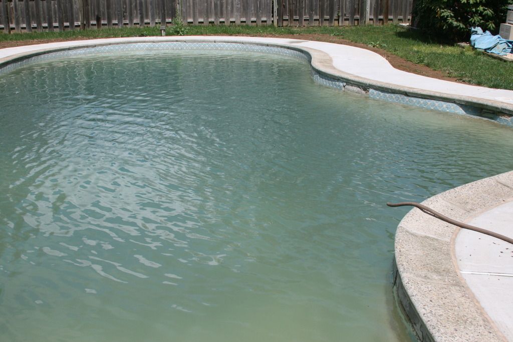

Ok, thank you both! Thanks for the tip on adding chemicals - I will use that in the future and for now just focus on the SLAM. Yes, I am adding DE in each time - we have a 24 square foot filter, so I've been add 3 scoops (from a DE scooper) after backwashing. I'm not having to babysit the pool so much today. I had an appointment this morning and was gone for 4 hours and I was still above shock when I got back - it has not dropped below since the posts yesterday helped me understand the process better!
Here are pictures from this afternoon. It looks even better in person. I can now see the light and the return in the deep end. The chipping paint isn't as bad, so far, as I would have thought having seen the steps.
Before:
Day2:
Before:
Day2:
