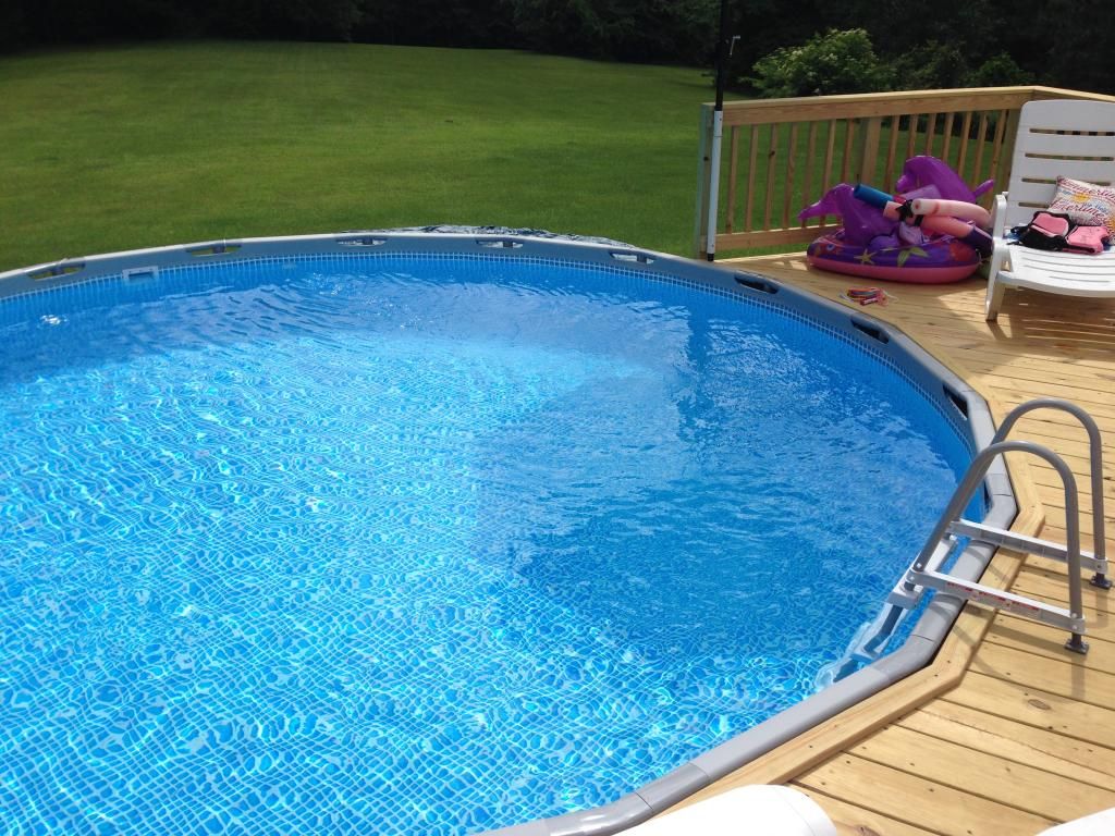

Ok...fast forward till the next weekend, time to build a deck. I had planned on making a small 6' x 8' on one side to make getting in and out easier. My wife took a couple of extension cords and laid them on the ground where she wanted the deck to be. Guess what....way bigger than what I was planning on. So here we go, it's about 340 sq. ft. of deck. I choose to use pier blocks for this build (first time) and I love them. I dug each block down about 2", just so it was setting on solid compacted soil.
Then I put up the 4x4's with their bracing and started the supports that will support the floor joists.
You will have to excuse the big jump in pictures....I got busy building and skipped a day or so of taking progress pics. So here is what it looks like after it's pretty much done.
I built some metal brackets that I used to attach the ladder to the deck. This is actually pretty solid....I am pleased with the way it works.
I bought a couple of 9' patio umbrellas and made some attachment points using some 1.5" schedule 40 PVC. There are 2 umbrellas and I can move them in 5 different places by just pulling a pin and dropping it into the other PVC. This will be handy with the sun in different positions.
I installed the Hayward thru wall skimmer like everyone on here suggested. HUGE difference!!! I have not had to skim with the pole a single time since I put it on. Awesome upgrade! I installed it with the pool level right where you see it in this pic. I split the gasket and no leaks at all.
