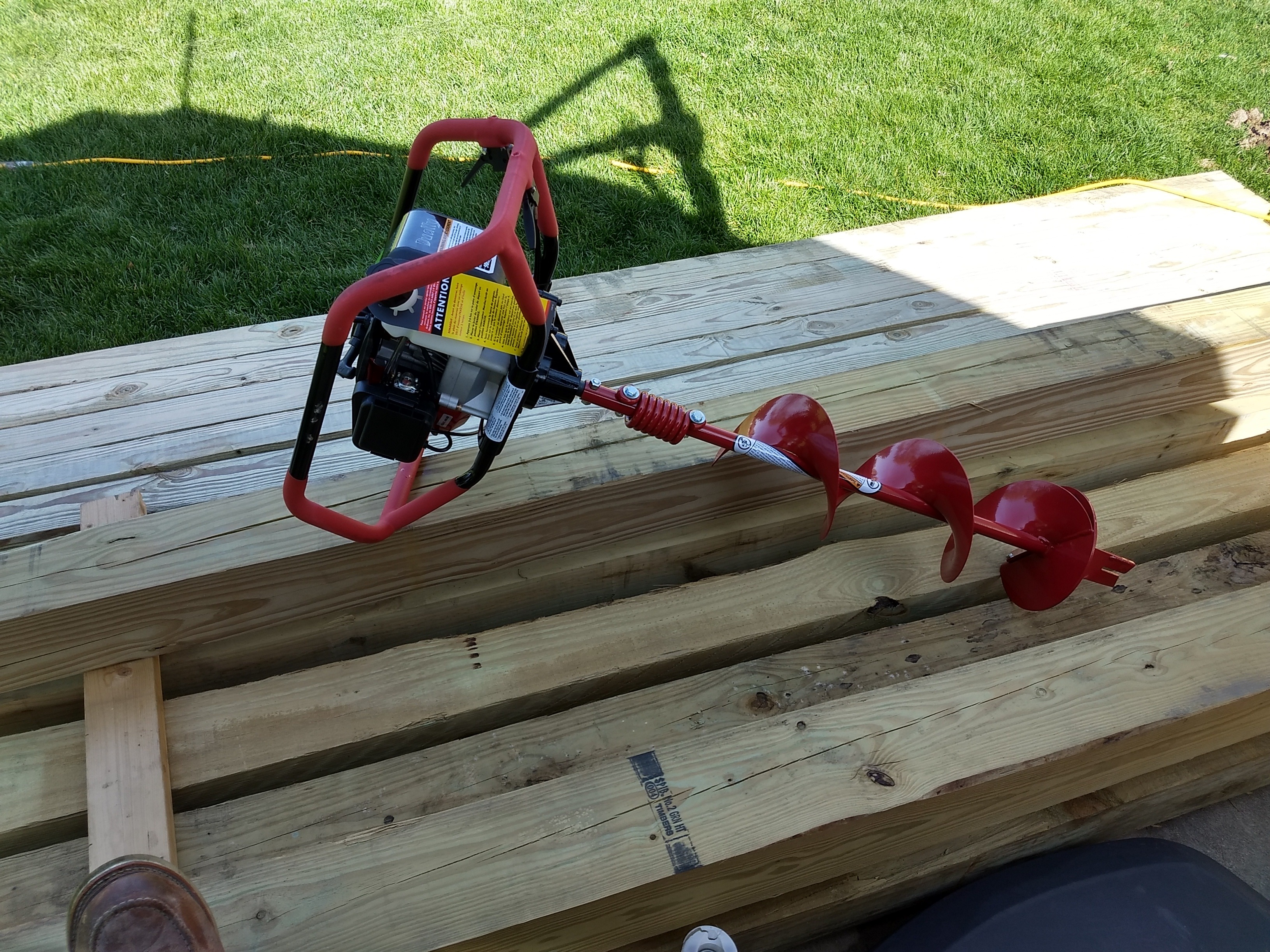

A picture of the auger I bought. We tested it on only one hole so far and at least for dirt it works amazingly well. We will see how it does with clay later today.

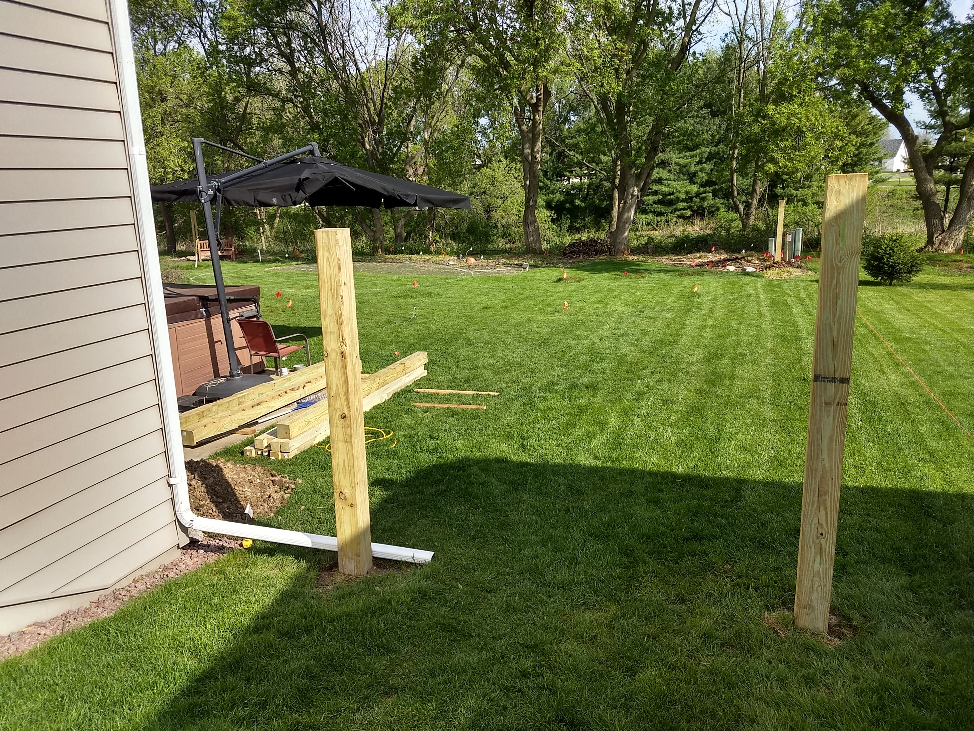

Last weeked we had gotten these two posts up. The original intent was to have an 8' wide double gate. We accidentally measured 8' center to center and so the width is 7.5', not wide enough to get a truck (at least our truck) through. Oops. I wasn't planning on driving back here often, and it's still plenty big enough for all sorts of other things to get through.

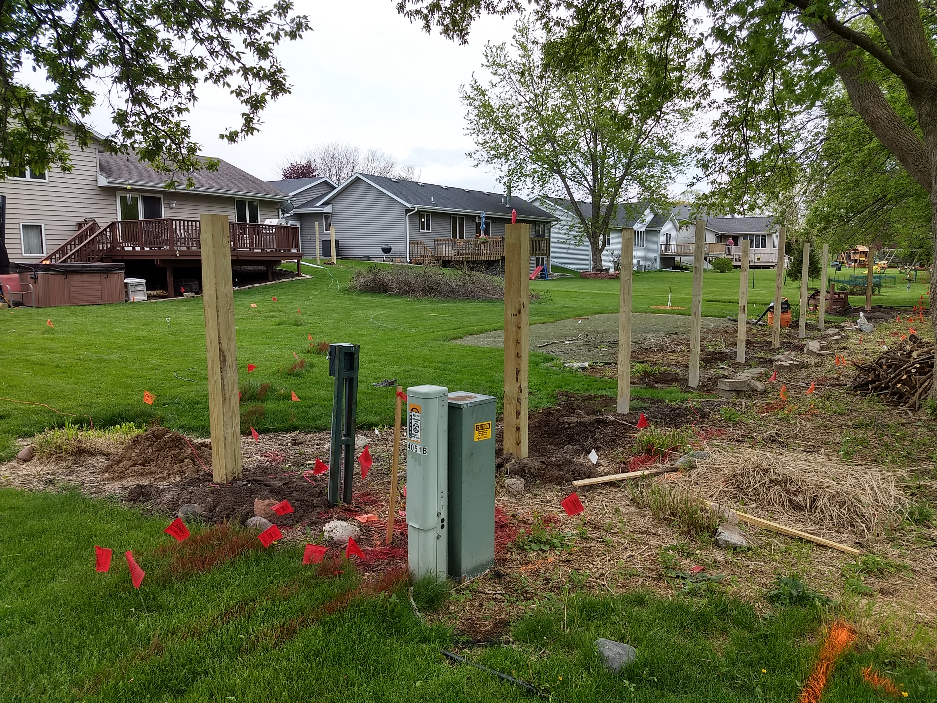

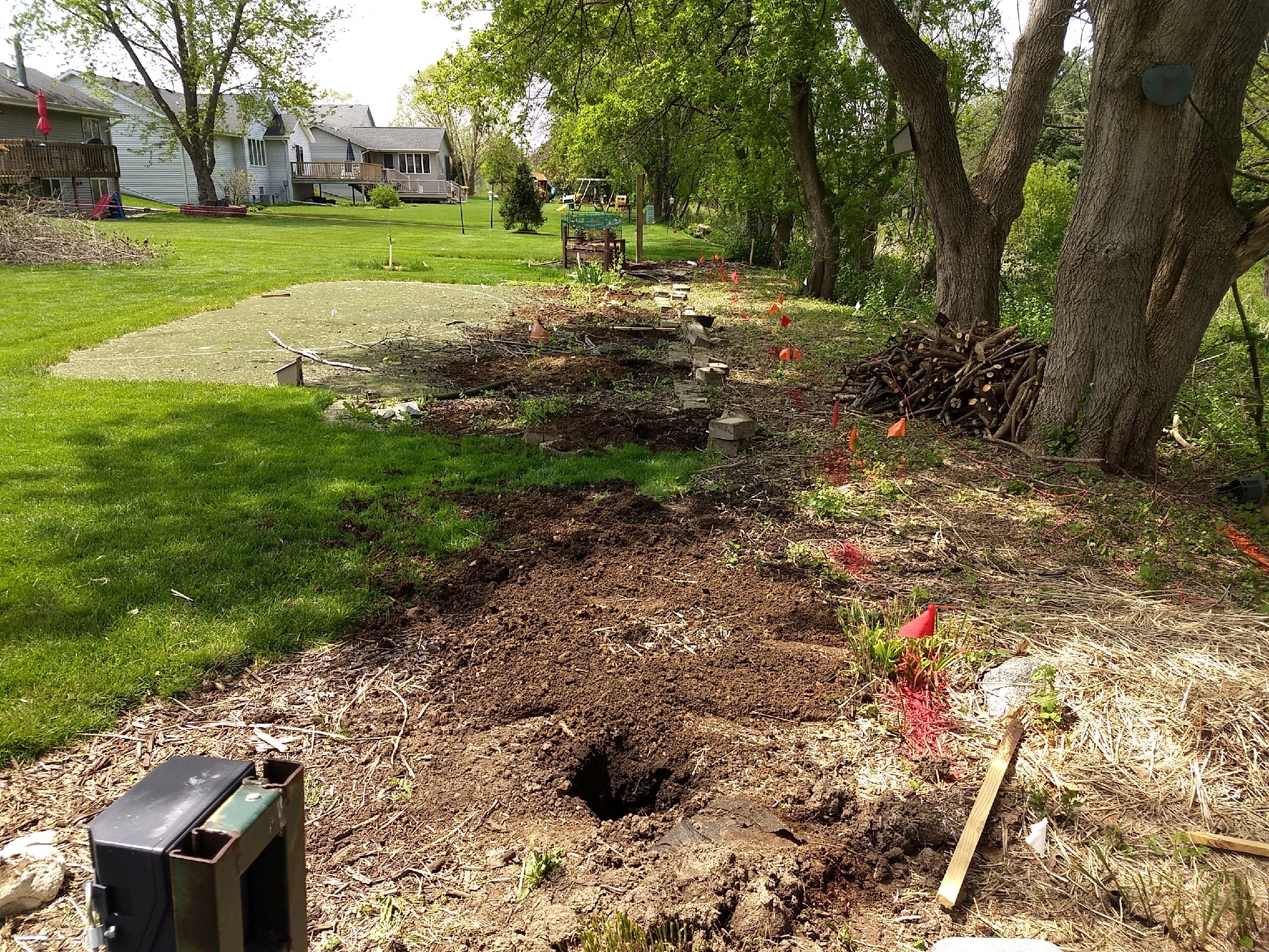

This corner post had to be 100% hand dug as it wasn't 18" from underground line markings. That wasn't fun, but wasn't terrible either. I was aiming for 4' holes, started getting clay at 3', solid clay at 3.5' so I had to break out my homemade clay loosener (hard pipe with a few small holes drilled in the end hooked up to a garden hose). That allows the clay to be loosened, then you suck out the water with a shop vac and get the clay with a clamshell digger.
This hole, also visible in the above picture, is another "corner" post. We'll run the fence from here to the other corner post visible at the other side of the yard. This is ~11' from the rear property line. The original intent was to run the fence up to the rear property line but we tried a hole last weekend, instantly hit a 2" root, cut it out, and hit another 2" root, and decided putting a fence directly up against trees was no good. We do have some plans for this area so it won't be all wasted space, but I'll cover that later.

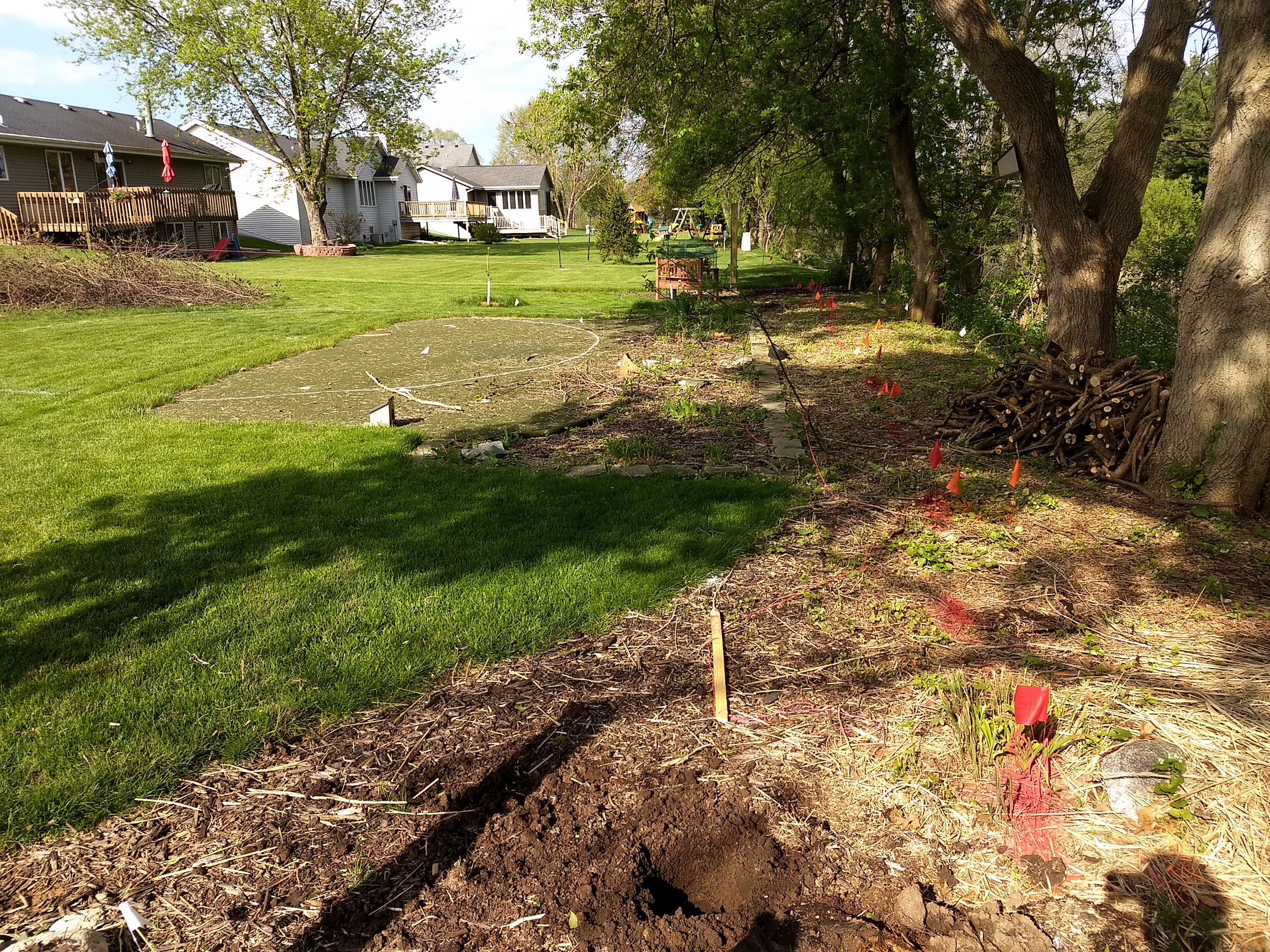

The other side of the house, showing a corner post. We'll also hang a 3' walking gate on that 6x6. The non corner/gate posts will have 4x4 posts, like the one shown here.
So, that's currently five of the six 6x6 posts, and one 4x4 post that's been set. The 4x4 posts should go better, an 8" auger will get through the clay much better than a 12" auger did. I've got a friend coming over around 10 this morning and the plan is to dig lots of holes with the two of us running the auger together.

Well, that went surprisingly quick. I've heard horror stories of hand held gas powered post hole diggers, but this thing was awesome. We did hit some roots and clay but this model has a heavy duty spring in the shaft for that exact purpose so it yanks a little then stops and doesn't tear out of your hands. We're both tired, but we have 7 holes dug to 4' (one to 3.5 cause we hit a root and said it was deep enough), and the remaining three holes on the back property line are dug to ~2'. One we hit a root and forgot to come back and dig it out, the other two we have too many rocks at that depth and it jams up the auger. So I need to clear a root and finish the one hole at some point, and hand dig the other two holes. Also one of the holes is a corner post so I'll hand widen for a 6x6 but that won't be bad with an 8" hole already dug to 4' deep.
My friend left, it's his anniversary so he needed to spend time with his wife. Plus we were both shot, lifting the auger full of clay with an extension is a bit tiring. After a break and lunch I'm going to come out and put some gravel in the bottom of the holes, then I'll put a post in each and my wife will hold them vertical while I drop concrete mix.
