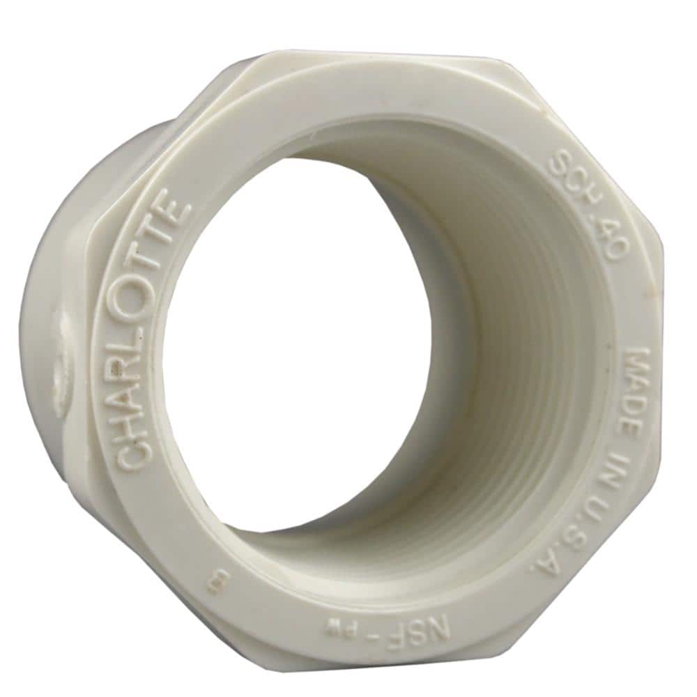

Hi,
I have what appears to be a 2 inch pvc with male threads, that I would like to connect to what I believe is a standard pool draining hose (maybe 1.5 inch). I have both pictured (hose just stuck in pipe to show the hose). I can't find what connector I need to attach the hose to the pipe to drain the pool. I've been looking for a couple hours on amazon. Could someone send me a link to the right part? It must be pretty common, but I can't find it!
Thanks!
Screw this onto the pipe:
Glue this into the SLP fitting above
Then screw this into the end...put hose over the connector, then use a pipe clamp over the hose.
