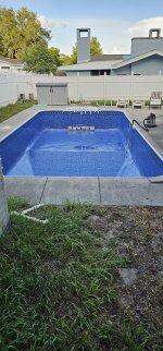

What saved us was the common close pin. Remove the spring and you have two wedges to lock liner in place as you go. Dozen or so was all we needed. Was able to easily secure liner as I walked around inside of pool, and didn't need others to help support line as I went. Had to do a rough fit first, then took it down to reposition. Note the close pins holding up liner in photos. Doing this ourselves allowed us to do it on our schedule, not others. That can be very important.

First test fit. Note the close pins holding liner in place.

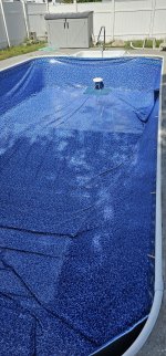

Adding water!
Final test complete! Liner used was Merlin Key Largo Tile 27 Mil wall, 20 Mil Floor, and was selected based on original liner life. If it lasts 10 year's I'll be happy.
Adding water!
