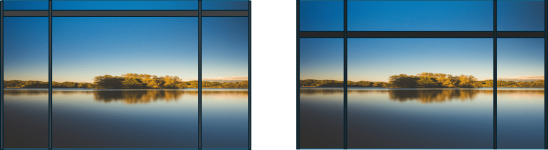

One last decision I need to make is on the shape of the arch for the enclosure. The house has 12' walls throughout so the structural gutter starts at that level and the main beams arch up 2' to max height of 14' to ~8' away from the house then are level for the next 8' and then drop to 10' at the back of the pool. There's another 2' section that juts out from the back of the pool over the infinity basin (or trough as many call it). This frames in the picture window in back of the pool with no vertical or horizontal cross beams. So the top frame is what they call non-balanced mansard where the frame is higher at the house side (looking at it from end view) than it is in the very back. This was supposed to create a large 10' high "picture frame" view from the patio. Question for @kimkats and other experts here: should I add two feet in the back to make the screen balanced from the side view or does this 2' drop-down make it more of a "picture window" that's different from the other views around the pool? This would mean the minimum height all round would be 12'. Structurally it's good either way according to the engineer. The engineer in me tends to want a balanced mansard. But I also know engineers are renowned for building ugly structures without the help of a good architect or designer.

OK, I realized my explanation of the picture window view might be hard to imagine. So here's my rendering of the view from the patio. It's close to scale and not perfect but does the subtle difference make one view better to the artistic people here (like @kimkats )? Which do you prefer the view left or view right? My engineer side has a preference but I learned a long time ago engineers don't build pretty without a lot of help from more artistic people.
Thanks in advance for taking the time.
Chris
Chris
Left...
1719319674757-png.589152
Reactions: proavia
