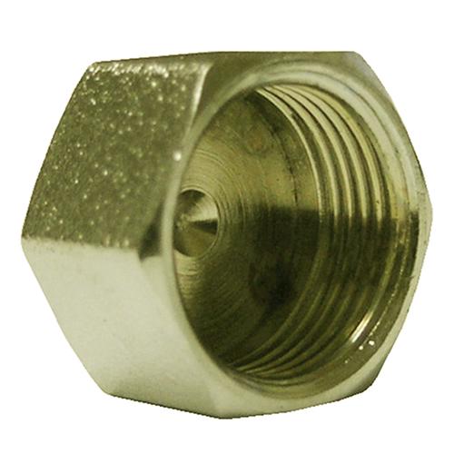

Bought some brass fittings. Modified caps to be the nozzles thanks to the drill press at work. Not the prettiest but we'll see how they work.

Yes. All the fittings will be brass. Hoping the threaded portion is long enough to allow me to tighten the modified caps to form a seal. Sticking with polyethylene tubing for now. Might switch to a more durable irrigation tubing if I find this stuff is getting brittle too quickly.
So... the caps I made because I like the shape because I'd like a rounded end rather than a square end to the cap are flare fittings rather than compression. I believe it's impossible to buy a 1/4" compression to 1/4" flare union or T ... I'll have to figure out a different cap solution. The flare caps screw on the compression union only about half a turn. No chance of a seal there...
I may have to go with this for a cap, but I don't like the square/sharp corners at end of the cap.
I tried the new caps with holes drilled in them... not so good. Even with minimal pressure, its like a sprinkler shooting straight off the slide. I'm going to need to drill/grind out a slot on one side of each cap at the end so the water shoots down onto the slide rather than a fountain... Kind of embarrassing that I didn't see this coming.
