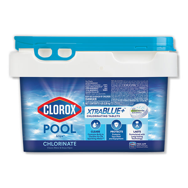

I may have found the culprit, I used chloring pucks early in winter/spring to raise my chlorine and CYA. I used looked at the pucks that I used, Clorox XtraBlue+ and it says that it contains 0.99% of copper sulfate. I will wait until Fall to remove/refill the water out of the pool.
