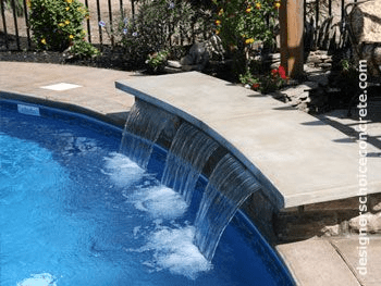

Hi everyone,
Does anyone have waterfalls on a radius portion of their pool and, if so, did you do flat-front spillways or radius-cut spillways?
We are planning on putting a combination waterfall/kid-jump-platform on our pool similar to the one pictured here:
The spillways currently planned are three 18" ones from INYO. The deep end of my pool is a 9' 6" radius circle. I can get the spillways either flat or radius cut to match. On this, I have questions.
Does the radius cut impact the look and flow of the water?
If the spillway is right up under the overhanging slab top of the structure, would you even notice a flat-front spillway protruding a bit in the center?
Gary
Hi everyone,
I posted over in the build forum, but then realized after getting no responses that perhaps I should have posted in this forum instead. We are planning on putting a combination waterfall/kid-jump-platform on our pool similar to the one pictured here:
The deep end of my pool is a 9' 6" radius circle, so perhaps a little tighter curve than what is pictured there. Hard to tell. Anyway, we were originally thinking of using three 18" spillways from INYO spaced about 6" apart. But then we noticed INYO can radius cut those things on request, and that leads to questions.
First question... does anyone know what kind of impact a radius cut spillway has on the appearance and flow? My concern would be a noticeably uneven stream with the outsides lighter than the center.
Second question is... if we used those 3 flat facing spillways as originally thought, does anyone think it would look too "blocky" on that curve? My better half thinks it would but I'm not so sure it would really even be noticeable.
Gary
I think you have no responses so far because few people have experience with radius cut spillways and even fewer can contrast radius cut with straight spillways.
I would mock up a 9'6" radius cardboard box to simulate the area and put some 18" straight wooden rods under it and see how it looks. I think18" straight may not be obvious in a 9' radius but I would want to see it.
Yeah, that probably makes sense.
We did a sort-of mock up by placing 18" 2x4 blocks on the edge of the pool around the corner, spaced out about where we would want them in the finished structure. Didn't look like they would really be noticeable, especially considering they would be up under the concrete lip of the jumping platform.
Thanks for the input!
Gary
