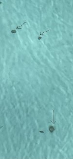

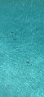

Sorry if this is a long post. I have these dark rings around what apper to be rough spots in my plaster. I also have what look like runs down the side of my pool in multiple areas. They seem to be a rust color but not for sure. I tried scrubbing them with a chlorine tab and a vitamin c tab. Niether changed there appearance. I post two picture one is of the rings and the other is a poor shot of what look like runs. Hopefully you can see them. My current readings are as follows
What test kit do you use?
How old is your plaster?
Please highlight the areas in your pictures with the spots and streaks you are concerned about.

I use the Taylor test kit regularly, but wanted phosphates and metal readings so i went to the pool store this time. I will see if i can highlight the photos.
