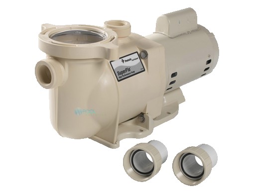

I have a Pentair Superflo 2 speed pump and love it, moves massive water on high and does great on power with low... Looks like it is 100 dollars more now, mine is 5 years old... I have a whole house surge protector and lots of lightning here also and no issues for 5 years :)
