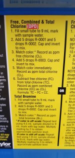

The k 2005 only tests fc to 10ppm as it includes dpd only.
The recommended k2006 or tf100 includes the all important fas/dpd fc & cc tests that test up to 50ppm.
Which is imperative to perform the SLAM process.
The fas/dpd portion can be added to your k2005 to essentially make it a k2006
Here 👇
Or here👇
Taylor K1515A Drop Test Swimming Pool Free & Combined Chlorine FAS DPD Test Kit https://a.co/d/eUEmdPD
You are kinda handcuffed w/ the 10ppm limitation - you can dose to 16ppm but u can’t confirm u made it there. This means u can’t really Maintain which is the staple of the S)hock L)evel A)nd M)aintain.
All u can do is wait until fc falls to 10ppm & dose to 16ppm again. This is the only safe way to proceed to prevent damage to surfaces & equipment.
Also note that the ph test is invalid at fc levels above 10ppm which is why it should be adjusted Before beginning SLAM Process.
During slam focus testing only fc & cc.
