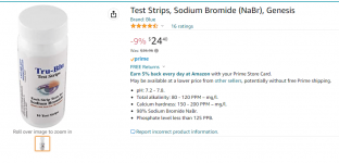

Bromide strips just showed up from Amazon, my bromide level is about 3100ppm, which the SWG manual says have bromine between 1500-3000
