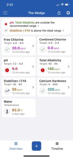

.View attachment 596331
You dont need to replace the sand. Why did you add soda ash? How are you testing the water?
The sand needed replaced as it was at least 6 years old. We did the soda ash originally because the pool math app told us to increase the CH. I’m using a TF-100 testing kit
Now our pH is super high, as is our total alkalinity
That is because you added soda ash, which is a hammer to raise pH and TA. The pH test is invalid when FC>10.
Pool math recommends calcium chloride or Calcium Chloride Dihydrate to raise CH, not soda ash. Calcium is not needed in a vinyl pool unless you have a gas heater, or potentially an SWCG.
I WOULD NOT ADD ANYTHING TO THIS POOL AT THIS POINT.
Let the FC come down, sun and swimmers will lower it. When FC falls below 10, test and adjust pH back to 7.2-7.4 with muriatic acid, and restart the SLAM process.

Appreciate your breakdown. Good to know it’s still safe to swim in, we’ll come out smooth as can be!
Not sure it is safe to swim. Your pH could be very high which can cause irritation. If you cannot see the bottom, it is also not safe to swim. I would not swim until you can test and adjust pH.

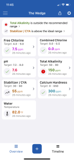

Edited to add: everything is back in level now except for the alkalinity. It says I need to put in acid and aerate. Is the muriatic acid the best choice? Or am I reading things wrong again 🤣
Manage your pH and ignore TA (test for it, but don't "treat" it). Yes, use muriatic acid. Follow this:
  1. When TA > 80: When pH gets to 8.0, lower your pH to 7.6. pH will rise. When pH gets to 8.0, lower to 7.6 again. This will lower TA over time.
  2. When TA is between 60 and 80: DON'T lower pH to 7.6. pH will be fairly stable between 7.8 and 8.0
If your Muriatic additions, when TA is above 80, are too frequent for your tastes, here is a guide to quickly lower TA. Link-->Lowering Total Alkalinity (TA) Quickly with the Acid Aeration Method
