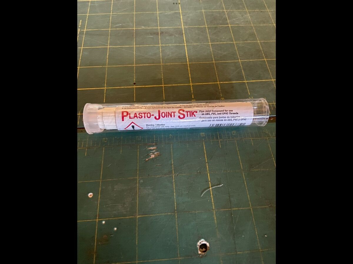

Try using Plasto-Joint Stik.

I'm not sure if I compromised the female threads. ?? Would the sealant you show be better?

Plasto-Joint is, basically, Teflon tape in stick form, but you its hard to get a large-enough amount on a PVC fitting to work well.
