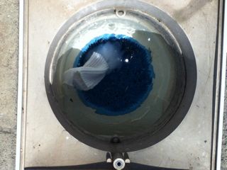

Photo of sock dropped in skimmer:

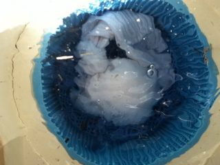

It did not take long for the sock to spread to cover a lot of the skimmer basket:

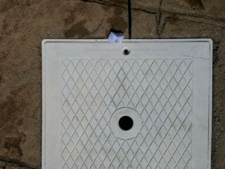

..so I trapped the top of the sock between the skimmer cover plate and the concrete.
I have started with one-half pound of CYA in the sock.
So after about 24 hours of the sock in the skimmer, and a squeeze or two about every six hours, probably 2/3rds of the CYA has leached out of the sock. I have added another sock to the other skimmer return basket with enough CYA to hopefully get me to 20 ppm.
