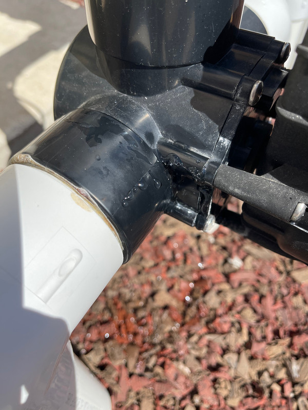

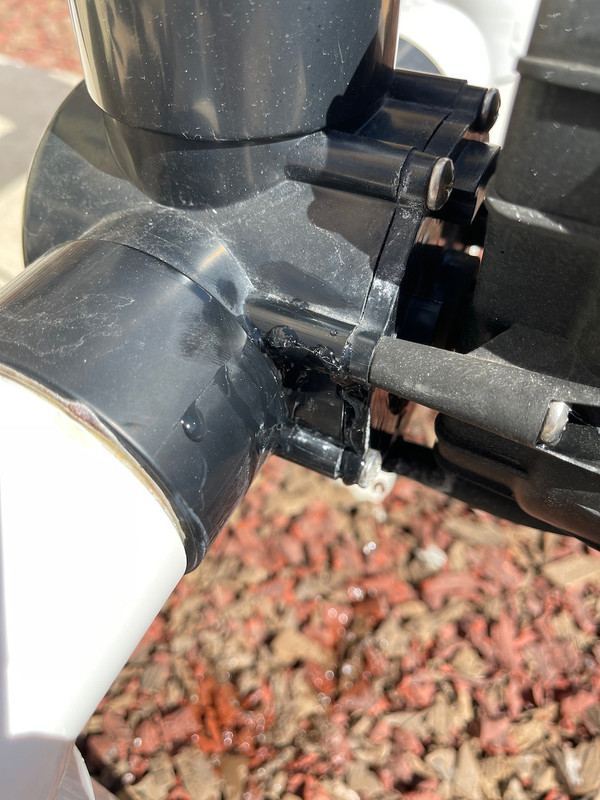

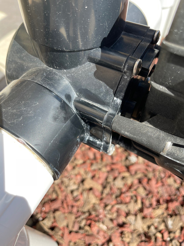

I only noticed after testing everything out this morning. The crack itself is so inconspicuous, only putting it under enough load to run the waterfall alone, caused it to reveal itself. My question is since the crack runs from the side-port to the screw boss, can I just glue a 2-1/2 coupler over the port end/elbow and then use epoxy to help close the crack from there to the screw boss?
My other course of action would be to cut it out and, either use couplers to put a new one in, or my preference would be to put some 2" unions in for the odd-case that something like this happens again. If I go that route then I will most likely put unions around the other 3-way for the same reason...and to retain the symmetry :)
Lots of folks will be trying epoxy fixes with all this. Some will work like a champ. Some of those will blow at 2 AM and the owner will waltz out the front door on the way to work not knowing about the backyard flood. Especially in the off season, that kind of thing could go unnoticed until there was a basement full of water or something else substantially bad.
if you are handy the pvc is dirt cheap. The valves are cheap too for the peace of mind they would bring
My $.02.

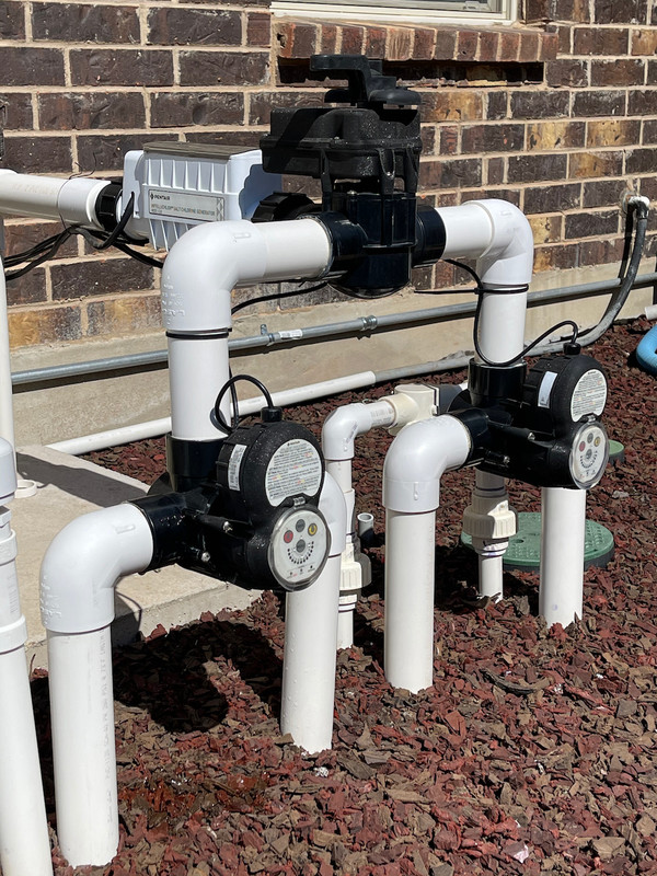

Oh believe me, I know this is a band-aid, but since it is only the valve that controls which water feature to turn on (waterfall or beach fountains) and not the main valve that diverts to returns or features (top valve in pic), then I feel more comfortable being able to keep eyes on something that is only going to be run for an hour or two while we are actually swimming. On the flip-side, I have done plenty of PVC work throughout my build...so much so, that I'm not looking forward to cutting into my plumbing again :p However, Pentair was kind enough to help me stock-pile some extra parts when I was troubleshooting an issue with them, so I really don't have an excuse on that front:
Ok this helps ALOT. Alot alot. But it’s still a band aid and you not only know in your heart what you need to do....... you have the ability to do it and some free parts to help.
So I’d like to change my answer to : it can wait but I just wouldn’t use the features if it takes a month to have the time. Run the features every few days just long enough to clean out the stagnant water.
