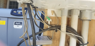

I think it's right. The gray one looks like the water sensor and it's plugged into #5 and 6. The gold one is plugged into #7 and 8.

Can you post pics? One should be drilled into a pipe with an worm clamp. The other just connects to a pole somewhere. You can see on the Aqualink door where each should be plugged in. As far as I know they are identical probes so mixing them won't matter as long as they are plugged into their respective ports.
Yeah 5 and 6 are water temp and 7 and 8 are air temp. Page 22 here -> https://www.jandy.com/-/media/zodiac/global/downloads/0748-91071/6594.pdf?force=1
I don't like when installers put the air temp probe underneath the panel like that. It tends to get erratic readings. Your pump is running, right? And that is your main or only pump?
