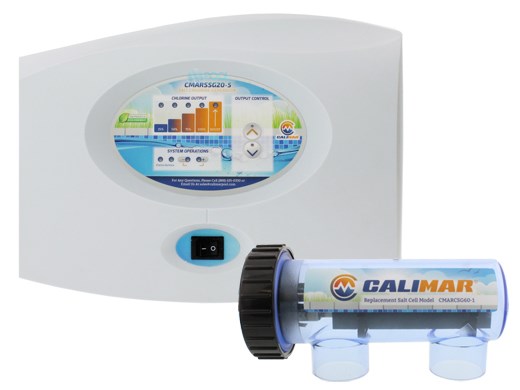

I had the swg linked below. It worked well for three years. I swapped it out to a different system because the cell design didn't work well while running the VS at low speeds. If it's still available, it is a good value at $625. I haven't seen any other similar systems price this low.
The Calimar system is a rebranded SGS Wave. SGS went out of business and was taken over by CMP (Custom Molded Products). They no longer produce this unit, but still provide cell replacements.
I'm not giving it's a strong recommendation, but it is a 40000 gallon unit close to your price range.
