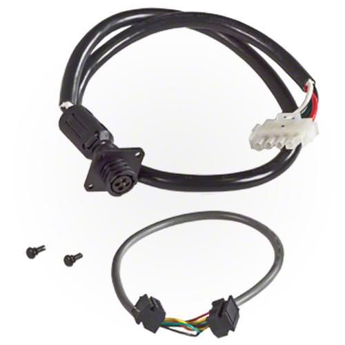

With the easytouch you would need to buy the IntelliChlor Power Center that the cell connects to and the Power Center connects to your Easytouch. The Installation guides describe how things hook up. Connect the Power Center power to the filter/pump relay LOAD screws.
Easier to get the power center, but If you want to roll your own, and install it inside your EasyTouch you would need.:
The SWCG transformer
The fuse
The Surge card
The cable that connects the surge card to the bottom of the EasyTouch. (See below)
The cable the connects the RS-485 com port to the Surge card.
