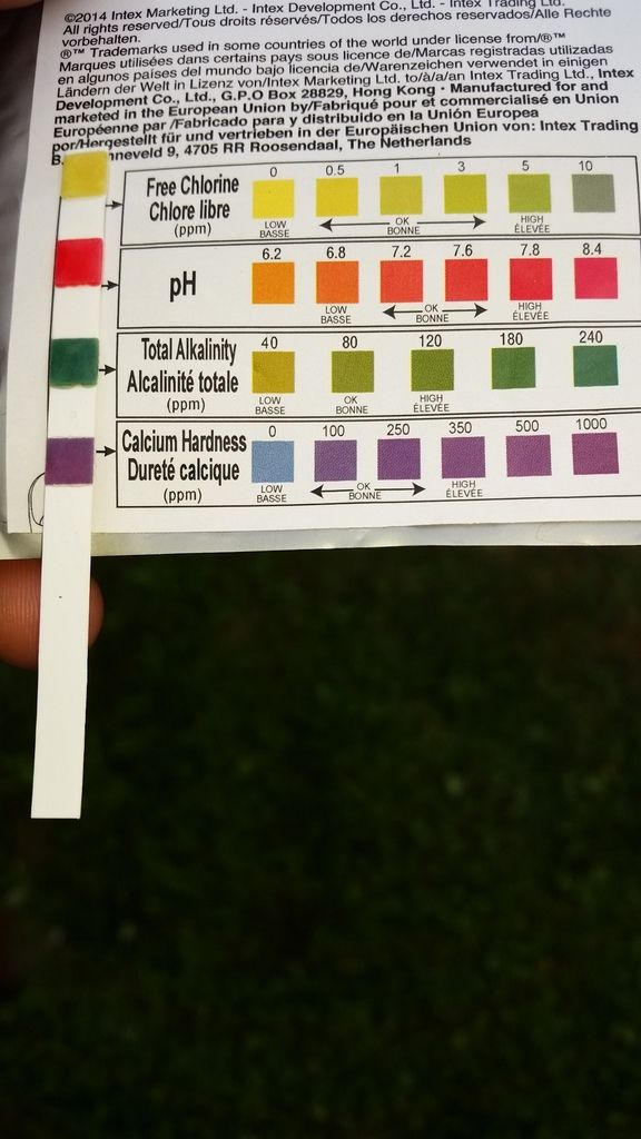

Finally got it up, All I have is the test strips it came with today. Using the pump/filter it came with and the Intex krystal clear salt water system.

You need to get a proper test kit, we recomend TFT-100 or Taylor K-2006C. Start reading pool school at the top, this will help you understand the way to manage your pool and the terms we use. First thing is to get some sand on the filter, do not drop sand on the PUMP basket. You can drain the water from the sand filter, there is a cap on the bottom to drain the water. After draining the water fill the sand filter making sure the laterals are correctly in place and are not broken. Make sure you do not drop sand on the center tube, most filters come with a special cap to fill. Then assemble the filter, put in backwash, and turn on the pump until clear water comes out the waste port. This will clean the sand. Then turn off the pump and switch the sand filter to filter and turn pump back on. Now you can start adding salt to the pool. Use Pool Math above to calculate how much to add, while you are there also calculate how much CYA you need to get it up to 70ppm, put it in a sock and hang in front of a return squeezing regularly to help dissolve. Now to the most important part, you need to add Chlorine to your pool, we call this regular bleach. As the same with other chemicals, go to poolmath and calculate how much bleach you need to raise FC from 0 to at least 8-10ppm. After that you can only guess as to how much FC your pool needs since you will not have the test kit(order quickly), so pour about 1 qt of bleach daily until you can test properly. Dont pay too much attention to the guesstrips.

[edit] I just remembered you have guess strips. They are not too bad with pH. [/edit]
