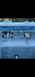

Morning. An update on the spa jet move. Unfortunately, the progress is very slow for a number of reasons. Below is a picture of 2 of the jets that have been raised. The jet on the left is in progress and the raising of the jet on the right is complete. The jets were at seat level and now have been raised by adding a 90 degree bend to the water and air lines to maintain the water and air mixing body in line with the jet. When complete, the six jets will be at 2-6", 2-8" 1-10" and 1-12" above the seat. We will be sensitive to the flow rate/gpm out of each jet since we have added many 90 degree turns to raise the jets. Comments are appreciated. Happy Thanksgiving!

Air and water line were moved separately and then recombined … pressure testing today … and then the patching of the spa jet holes will occur next week … one other comment. I know there has been a timeline headwind for various reasons, but we are in week number 24 of our pool build … with at least 6 more weeks to go. How does a 30 week spa/pool build timeline sound to y’all. We were told 16-18 weeks at the start … thanks for your replies .
