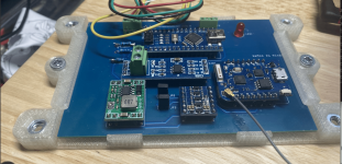

I found out about this when trying to locate a replacement for the spa control that is unreadable and partially working , an old SPALINK® RS 8-FUNCTION. So when searching on Ebay for a lower priced unit I found a posting for an interesting board that will take care of the Spa controls and more using my phone and Alexa. Did some digging and found the manufacturer website and pulled the trigger for $225.00.
Unit came in a week and was fairly easy to install , only change I made was designing and printing a 3D frame instead of using the recommended velcro attachment. Instructions that came with the board were pretty good , allowed me to install and configure the board in about 30 minutes. So far it works flawlessly and added Wifi control trough Alexa from where I can monitor and operate 8 functions and see and set the temperature of the water which is really neat. I don't know how well will going to hold in time but for now it's awesome. Here are some pictures of the installed unit and the link : Smart (Alexa) Spa Remote Jandy 8 (Emulates Jandy 8 button spa remote)
