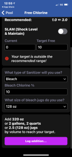

So according to this I need 2.5 128oz jugs to raise to 10ppm.
2.5 did not raise FC at all (tested right after, ten minutes after, thirty minutes after. Eight jugs seemed to get it to around 5FC, but I ran out of liquid chlorine and since I did this last night, Icouldn’t get more. This morning FC is reading as 0.5. The sample is barely pink before test.
The pool is blue and cloudy.

I would say something is interfering with the test, the jugs weren't nearly as strong as you thought, or there's something in the pool (not necessarily algae) that's burning up the FC. How soon after adding did you test?

Then it's something in the water. Likely algae. Need to add more FC and maintain that SLAM level for your CYA level. :)

2.5 gallons might work in a normal scenario - a regular day. In your case, the water has something unusual eating the chlorine, perhaps ammonia. That is the reason for the 10-min drill above. Waiting longer doesn't help the chlorine work better. It has to be done quickly. This is like a sprint, not a jog. If your pool was smaller I'd say exchange some water first, but that's probably not practical. So you're going to need a lot of chlorine at first until you break that FC-eating cycle.
When you add the chlorine, it WILL disappear extremely fast. Be prepared. If in 10 minutes the FC crashed below 5, increase right away with more. Don't wait. Do this until you are sure the FC shows signs of holding between 5-10 ppm. The higher the better. Hit it aggressively and you'll break that cycle. Then things will stabilize.
