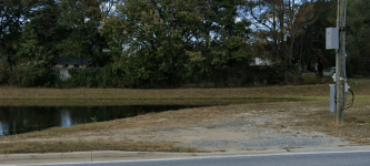

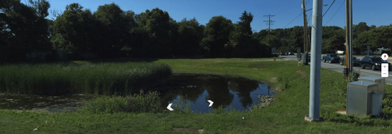

And this traffic signal control box looks pretty new (well in 2019). The more I look around the area, I would be highly suspect of lots of stuff at that intersection.
Yeah I know, people screw up but the more I think about it, the less convinced I am about an exposed 120v line. That just seems like an extreme cause that someone else would have noticed by now. I think it may be more subtle than that like an unbalanced load (3-phase or split phase) that can also cause stray voltage. There is definitely current traveling underground but it doesn't need to be an exposed wire to cause that.
Same here. A live exposed wire would blow its breaker or there would be an arc fire volcano bubbling in the pond.
What about our original bad neutral thoughts, but at/near the pond instead ?
Looking at Bing maps, I would REALLY suspect that intersection. Although I am sure of the date of this image, but it has been changed a lot. The Google street view seemed to show some lines were also put underground (you can see the conduit and old utility poles next to it.)
Did anyone else notice the ducks swimming in the pond.
Even though the pictures are two years old, they probably still visit and if that water was energized by 120v, there should be at least one dead duck around that pond.
What pictures show ducks?
