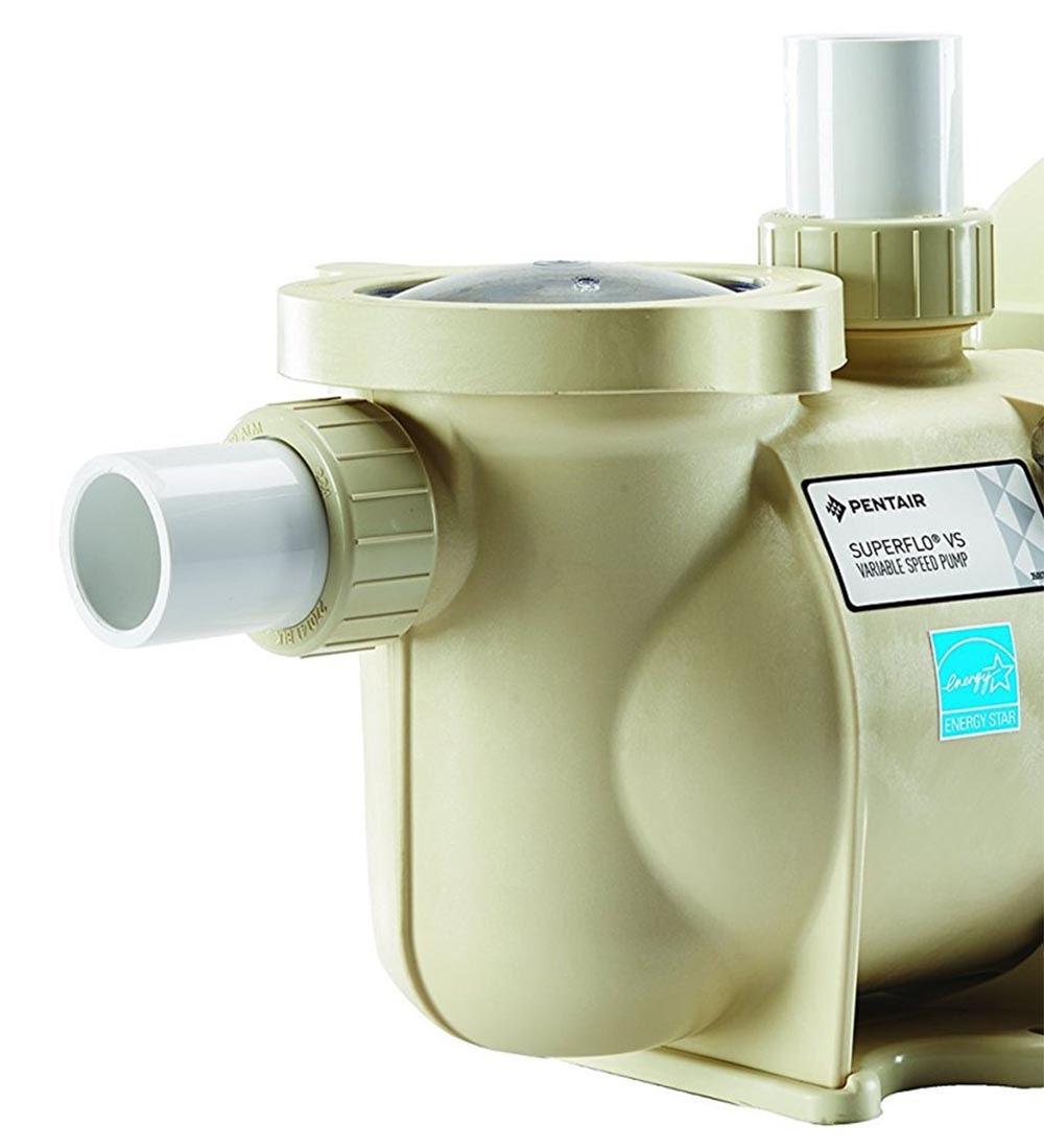

I think you have it correct. Most pumps that I have ever seen have threaded connections (what you are calling quick-connects). Many of those are proprietary. They include the plumbing half which usually glues onto your existing plumbing. You only really need those as you will be able to remove the pump for servicing/replacement just by unscrewing the pump behind. A union is essentially the same thing. It is a "quick connect" fitting. The difference with unions is that you can go buy them anytime for about $5. Again, you don't need them and most people do not add the extra union.

So if I were to unscrew those two threaded connections in the picture, then the pipe should come straight out and I could walk away with the pump (after removing the electrical connection as well, of course!)? If so, that's really the main thing that I want to achieve!

Yes, unscrewing those two would release the pump for removal.

That's what most people call a union. If that's what the OP is going to get on his new pump, then he's good to go.
