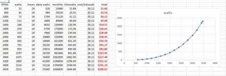

So I've been thinking about this... ALL of my pumps are 230V single speed pumps. All currently working fine. It costs me roughly $380.00 per MONTH to run my pumps based on the my current usage (based on hours per day each pump runs, on average).
The biggest cost right now, and that's just because it runs WAY more than my other pumps is my main FP, so I'm considering replacing it with a Jandy VSFHP270DV2A variable speed pump (Jandy Variable Speed Pump 2.7 HP: Most Powerful Pool Pump | Jandy) . The ROI on the remaining 5 pumps would take me forever to recover, based on the minimal current utilization that I actual use them each day, so I'd probably only replace those as they fail.
Three questions.
1. I am TRYING to figure out, how much savings there would be with the Jandy VSFHP270DV2A variable speed pump. I see that it uses 2,250W at 10.5A, which I assume is at FULL RPM (barely less than my current single speed model). But I don't see anything in the Jandy specs or documentation that show my the Amps/Watts used at LOWER RPMs? (so I could calculate potential savings) --- How do I figure out, Amps/Watts at a lower RPM than MAX?
2. I'm not even sure I could run a VSP for my main FP at much lower RPM, only because my main FP provides for a) my 2 pool returns, but also b) my Caretake in-floor head system (37 heads, across 8 zones). I feel like lowering the RPM, might not let the in-floor heads pop up enough under pressure, and I might still need to run the VSP mainly at full RPM regardless, which would then negate any cost savings. Any thoughts on this one as well?
3. Am I wrong in thinking that the ROI on most of the other pumps (aside from my main FP in row 4) would take 10+ years to recoup and is only worthwhile if a pump fails?
I guess one nice thing about doing the spreadsheet is, since I used formulas, if I want to adjust a pump to run Y hours per day instead of X hours, now I can see how much extra $ / money that will cost me. Pretty handy.
Three questions.
