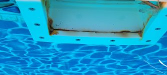

I've got what I believe are rust stains in the pool. Last year, there was some noticeable around the skimmer housing, but that was about it and I didn't really worry about it. This year, I put a protective mat under the removable steps and seat I installed, and when I pull them up to clean, there is slight orangish staining evident next to where I can see the bright blue liner where the mat was. I also noted some rust spots on the vacuum skimmer cover (it is in place most of the time, as it runs a suction cleaner most of the time.)

Can you post some photos of the area? Vit C tabs should be crushed into a powder inside the sock...

Pics are from this afternoon after sweeping up some dust that had accumulated. I had mats under a bench and steps, and the stains are most noticeable where you can see the edge of the mat. The phone camera didn't capture the yellowish color of the liner very well compared to the blue under where the mats were, but you can see the line.

Anyway, I have what I believe is some iron/rust staining on my liner, and the skimmer. I think it came from the anti-kink spring that was on a garden hose I'd used to send water through my homemade heaters, as the fill water tested low.

Low pH causes wrinkles in liners.
Much of what you read about stain treatments is aimed at plaster pools that can take a lot more abuse then your liner.
I would be careful about being too aggressive in treating stains in your liner. The stains are only cosmetic but the effects of the stain treatments can damage the liner.
Sequestrant is unlikely to last through the winter and there is a good chance the stains you remove right before closing will redeposit on the surfaces. I would wait until you open the pool int he Spring to do any stain treatments.

I had some vitamin C tablets, so I crushed them up, strapped to the brush, and was surprised at how readily it took up the staining. And pleasantly surprised that the cleaned liner didn't look as faded as I had thought!
