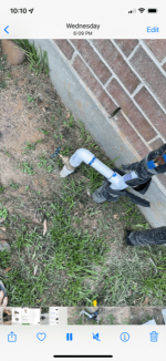

Recently went through remodel. My pool was old no autofill or overflow. I put the overflow in and bought a level smart. I modified it though. Looking at the 200 sensor etc wifi lot you don’t need. Take a look at this I wired the valve to OmniLogic relay and I’m good to go, by the way that valve they sell you is same thing sprinklers use 20 bucks at Home Depot. With this integration you know when your filling and can safely automate filling like daily small amounts adjust accordingly. Just thought I would pass this on; that is plumbed into return btw.
You can save a lot of money this way you can wire to jandy iaqualink the same.
