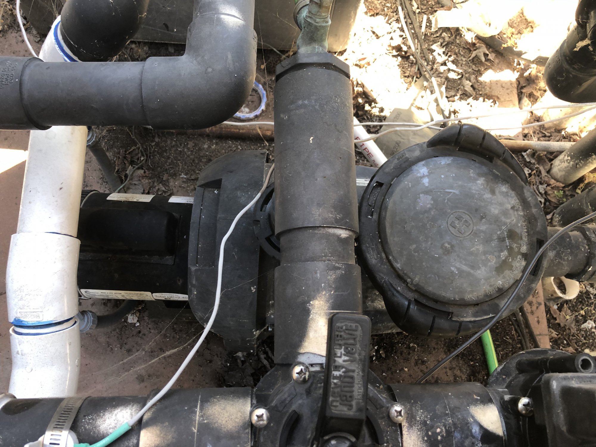

Just came back from vacation and main pump won’t start. Pool is murky and have no clue how long the pump was not started. I put the system in service mode and recorded a video . Any suggestions are highly appreciated.

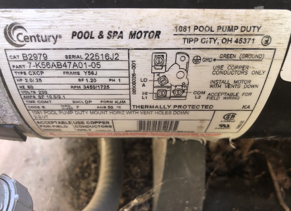

Provide us more detail on the pump/motor including pictures of the labels.

Type CXCP has 3 capacitors.
There is a run capacitor for high speed.
There is a start capacitor and a run capacitor for low speed.
The top hump contains a dual run capacitor.
Check the capacitors, measure capacitance and replace if bad.

The capacitor is probably bad.
I would replace the capacitor.

With the controller in service mode I can start the pump and low speed , I got rid of the air and looks to work fine no strange noises so I went a step further disabled the low speed and high speed kicked in and I should ahve left it at that for today but I tried to see if that will work again and it didn't , once the pump is set to low speed it will start but doesn't revert to high speed any more so with my very little knowledge of electric motors I would assume that is the capacitor like you guys pointed out. If you can help with the correct capacitor spec I will start looking for a replacement ASAP.
The controller might be misconfigured and sending power to both windings at the same time or it might be just a bad capacitor.
Remove the capacitor and check the specs and a local pool store or electric motor repair shop should have a suitable replacement.
