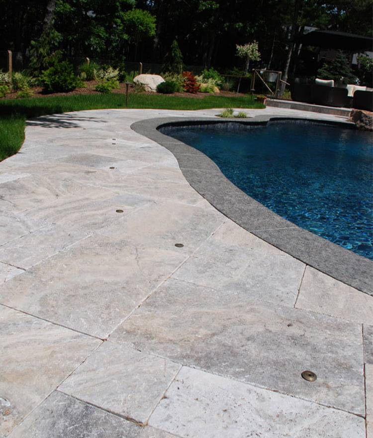

but for the pool decking, I like the slabs here -
the coping that would look nice -
IN Texas most people use travertine around the pool for coping and deck. But I've seen some spray texture samples for decking and they look alright . The question is, how do they feel under the feet? Travertine is no slip and keeps cool in the ridiculous Texas Heat. How do man made concrete Belgard pavers do around the pool? I have installed them on a backyard porch area and they are fine for that situation.
So because I'm on a budget, I'm exploring the option of spray texture to mimic natural stone look.

Both of the two you posted are VERY pretty!
The spray deck such as Kool Deck does good on the feet and is not too slippery. It comes in different color and can be textured sort of. I think the on right above this is color concrete but it is hard to tell from the pics. You will have to do some VERY good prep to make sure anything you spray on will stick and stay stuck for a LONG time! That will be the hardest part in my eyes.

There are a lot of contractors who specialize in the overlay here in Texas, the land of never ending development. I'd ideally like the travertine pavers and coping, but that's going to be $8k and not reasonable for what I want to do. Right now I'm thinking travertine coping with spray deck around.
Something like this with a different color scheme -
