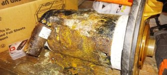

Got the pump impeller taken apart this afternoon. There was nothing caught in it to impede it. The only thing wrong was the o-ring around the diffuser was pinched in one spot. At this point I can only assume the pump itself is losing its effectiveness. I just wonder what causes a pump to fail, or in this case, lose its effectiveness. It's basically an electric motor. I've got wood shop equipment with motors older than this pump.
Anyway, I guess the next step is to figure out what pump to replace it with. Mdragger88 has already mentioned a VSP. I'm open to suggestions.
I learned a bit more about my pump tonight. I always thought it was 1.5 hp. It turns out it was 1.0 hp. I'm amazed it has done so well for as old as it is. When I took it out the cover for the start capacitor came off in my hand. There's also considerable rot in the motor housing. Definitely time for a replacement. I've decided to replace the motor only so I don't have to replumb anything. I'm going to upgrade to a VSP 1.5 hp if I can find one that will fit the current crock, impeller, etc.

I thought I'd share a couple of pics of the pump I just pulled out. I am amazed it was still working, albeit not well this year. I've not had any luck finding a variable speed motor that will fit my existing plumbing. I'd prefer to not replumb anything. I've actually started to wonder if I could put a rheostat on a single speed pump. Anyway, here are the pics.Pump.jpgpump1.jpg
