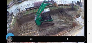

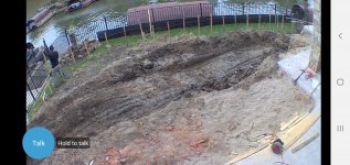

Dig happened yesterday and rebar today. Plumbing tomorrow and engineer inspecting the following day. Hopefully gunite next week.
