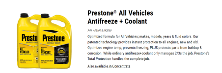

1696513150416-png.534142
1696513228531-png.534143

Engine coolant is different from Marine Antifreeze.
It is usually Ethylene Glycol.

Marine/RV antifreeze should be the same as Pool antifreeze.
Engine coolant is different and it should not be used.
