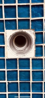

We had our pool done with blue iridescent glass tile and laticrete translucent epoxy grout. It all looked amazing in the beginning but we are now noticing white built of scale over the grout and glass tiles. :( . PB balanced the water and
added scaletec products but its not going away. I dont want to use harsh chems or beads blasting on glass tiles.

Welcome to TFP.
I think your problems are caused by Efflorescence - Further Reading
Was a waterproof membrane installed before the tile? See layers 1 & 3 in the diagram below.
What was the buildup of materials under the tile? Below is the recommendation of a glass tile manufacturer....
https://cdn.shopify.com/s/files/1/0429/0022/6199/files/OGT-Pool-Water-Feature-Installation.pdf?v=1625588595
1626430671428-png.355575
The efflourescence is from moisture behind the grout pushing calcium and such forward. It is less a matter of the pool water itself.

Thanks fellas. I have intellichem and a pool maintenance guy but he hasn't dealt with epoxy grout and full glass tile pool so not sure what can even come out from glass and epoxy!.
My PB used the same Oceanside installation method and followed whole 7 steps with all laticrete membranes and mortar bed.
Even transparent pool fittings are now coated in white stuff which wont come off even with sandpaper, white vinegar and baking soda.
Any further insights are appreciated..

Pool has Pentair salt chlorinator to maintain chlorine and intellichem does the water chemistry ie acid injection. here are the readings from intellichem
Could it be something different than calcium buildup as it doesnt come off with vinegar?

Vinegar may be too mild an acid.
Try a diluted mixture of muriatic acid. Start with 10:1 dilution and then increase the strength if it does not work.
