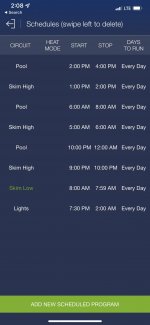

However, it's been a nightmare to program the 3 speeds that allow me to have 3 turnovers. I've tried to run the lowest speed from 8 am to 7:59 am (24 h) and then add schedules to run the pump on high and medium speeds throughout the day. The problem is that the Dang thing works whenever it wants. Yesterday I saw the schedule being followed and both high and medium speeds kicking in. However, this morning it didn't happen. It was supposed to kick in high at 1 PM but it didn't. I'm sure that I'm doing something wrong.
I've got to the point that I've been considering having only one schedule, to run the pump at its slowest speed and add both the high and medium speeds to run once every day.
This is the schedule and as you can see it was 2:08 pm and the Skim High of 1 PM didn't run nor did the medium (Pool) that was supposed to start at 2 PM. I'm pretty sure that the schedules of 5AM and 6AM didn't run either. What I don't understand is why yesterday evening both schedules for Skim High (9 - 10 PM) and Pool (10 PM to 12AM) ran perfectly and then switched to the lower RPM for the night. I'm sure missing something here.
